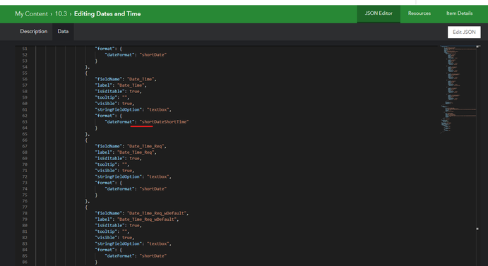

@SineKelly17 Actually, there is one more thing you can double-check:
Using the ArcGIS Online Assistant https://assistant.esri-ps.com/, looking at your web map's JSON, see the dateFormat for your fields. For example below, a field that displays also the time will have
 "dateFormat": "shortDateShortTime"
Potentially, as a workaround, you could update the JSON here with the dateFormat you need (copy-paste the value from a field that displays properly to make sure your syntax is correct).
I have a feeling this bug may be tied to the web map JSON not properly being updated for date formats when it's being updated in the web map pop-up configuration.
