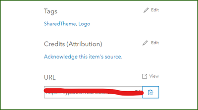

VickyWang
go to your image content's item details. copy the URL at the bottom.
past the URL into a new tab of the browser, make sure you can see the image in the new tab.
use the URL for your custom image. make sure your image type are: jpg,gif,jpeg . the image size is 120x120 pixels.

VickyWang
In the item details page of your uploaded item. are you able to see the URL on the right-bottom of the page?
Click on the view link, next to the URL. it then opens a new tab in the browser and shows your image.

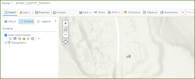

Hi Vicky:
Still haven't been able to use my image.  It's a simple blue triangle that I found out on the web.  I do know what you mean by the URL that shows at the bottom right when you choose an image.  I have seen that with other images I have.  But the difference may be that my blue triangle is not a "Map Image Layer?"  I do see the URL on some other map image layers I have.  But when I bring in this triangle, it also only allows me to View in ArcMap or PRO.  So something needs to be changed with the image itself.
I have another image, a .gif, from a customer that I want to use as a symbol.  When I try to "Add Item" and add this .gif, it says that type is not supported.  When I try to Add a .png, it comes into my content no problem.  But still  no URL.
