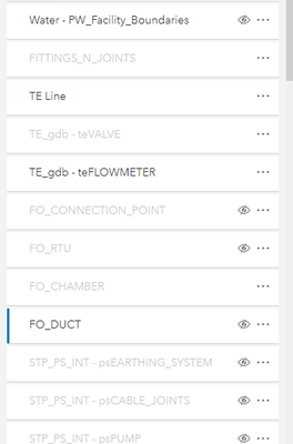

Hello Community,
Kindly, I've a Web Map in ArcGIS Online which contains many feature layers, and I'm wondering if there is an option to make all of these layers in Alphabetic Order. The below screenshot illustrates some of the layers I've now.
Thanks in Advance!

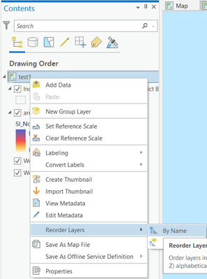

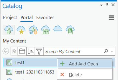

If you have access to ArcGIS Pro,
1. Sign-in to ArcGIS Online from ArcGIS Pro (if not yet done). Add the web map to ArcGIS Pro.
2. Sort Layers by Name.
3. Share > Save Web Map
* While testing, I would recommend to Save as a New Web Map. Sometimes the symbology of the original layers in the webmap could change.

Abdullah_AlFazari
Hi Jayanta,
This is a brilliant solution. I just tried it and it worked smoothly with me. Your support is highly appreciated.
