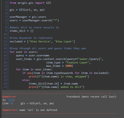

@AustinAverill When I run the script it gave me this error message:
George_Thompson
Esri Notable Contributor
you have update the URL to your Online one, then put your username (un), password (pw).
--- George T.
