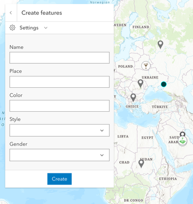

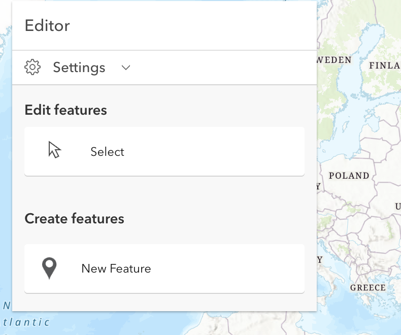

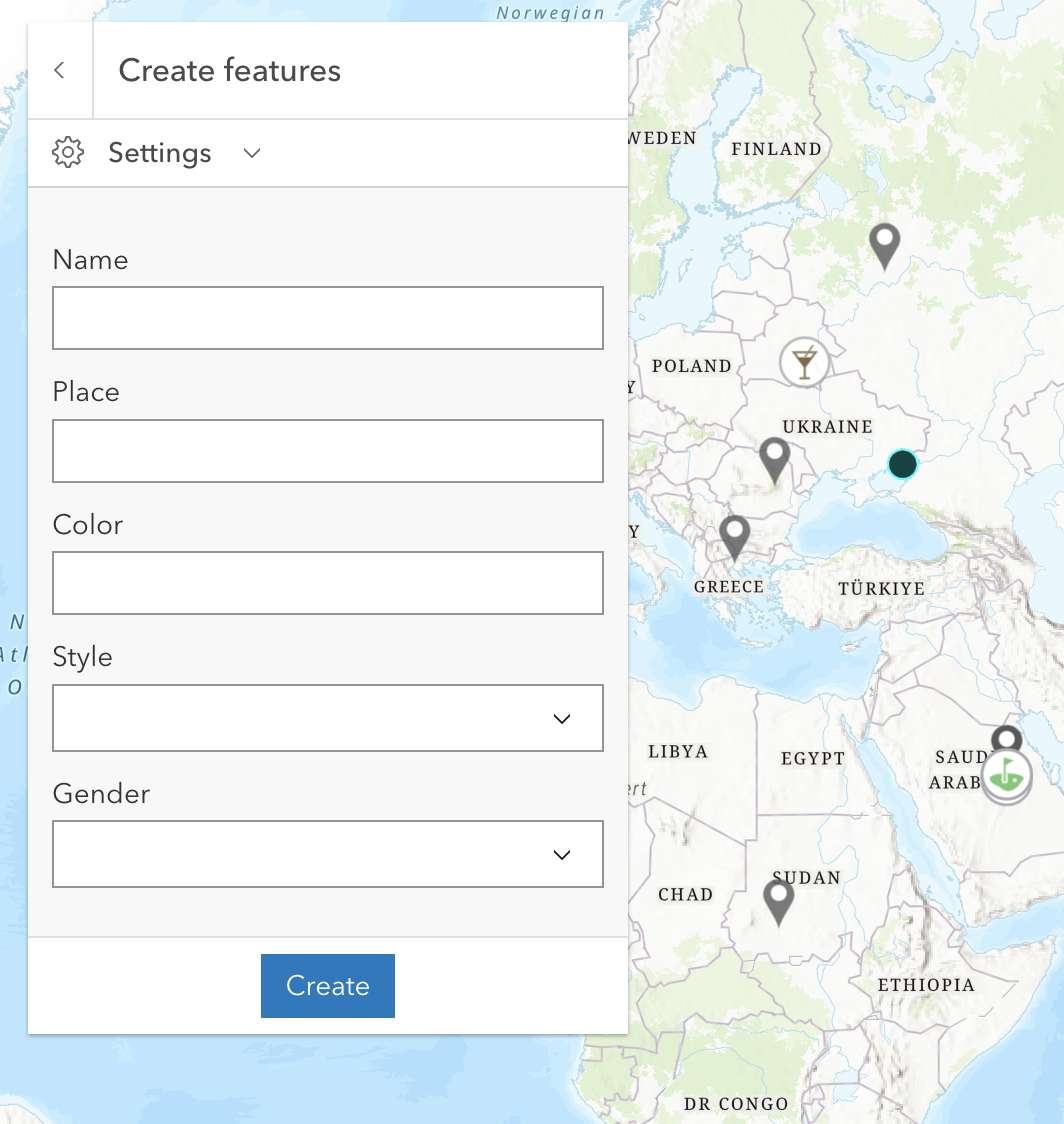

Hello,
I am currently in the process of integrating the editor widget, and I've encountered some challenges. Specifically, I am seeking guidance on how to incorporate various question types, such as radio buttons and checkboxes, within the widget. Additionally, I am interested in attaching event listeners to buttons like "submit," "update," and "delete" to facilitate calls to our application's API.
Any assistance or insights you can provide on these matters would be greatly appreciated.
Thank you.
Best regards,
Ankit Kumar
Screenshot 2023-09-25 at 4.44.33 PM.pngScreenshot 2023-09-25 at 4.50.23 PM.png

Thank you, Craig, for your prompt response. I was actually attempting to utilize a form template, but I came across a syntax element that suggested adding a container: 'some DOM ID.' It appears this might be an attempt to place the form outside of the editor, depending on the container's placement. Could you please clarify this for me? I have also included the code snippets below to provide further context.

Thank you! I was able to load various input types using the form template. What is the input element used for checkboxes in ESRI?
CraigGillgrass
Unfortunately, checkboxes are not supported in the Form Template at this time; only combo boxes or radio buttons are supported.  I know the team responsible for this has checkbox support on their roadmap but I don't know what their timeframe is for support.
