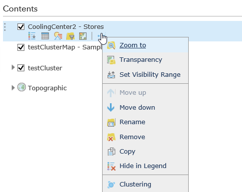

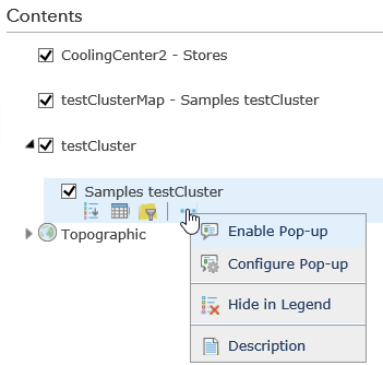

I want to try the new AGO Clustering option but for some reasons, I'm not able to access it in any of my services published with AGS 10.3.1
I've added two services in AGO :
  • The one published by my server for which I can't apply clustering because the option is not available
Both services are feature ones, in WGS84, respect the considerations mentioned in the ESRI documentation.
What is wrong with my service ?

Here's another good read about pagination: Error: Pagination is not supported, it shows you where to look in the REST service to see if pagination is supported. It should work for you if you upload to AGOL - I was able to get it to work with our data. Another reason to (hopefully) upgrade SQL soon.
KellyGerrow
Esri Alum
Thanks Brian,
We are going to include the requirement of enabling pagination in the considerations for configuring clustering in the next release!
