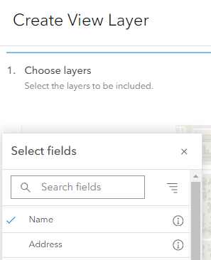

Another option would be to create a separate, editable view of the layer that displays only the fields you choose. This would affect not only the editor, but any apps consuming that view.
Either way, these would all point back to the same service.
