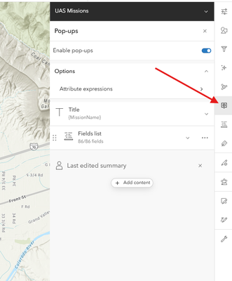

It is in the map viewer, click on the layer you want to update pop ups for and then on the right click on pop ups. Make sure they are enabled to access the ability to add elements.

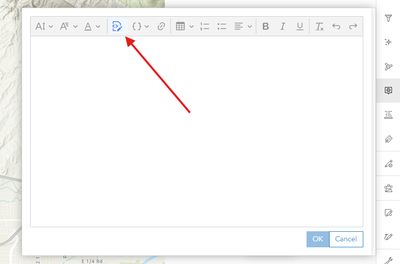

@Brian_McLeer This is a really interesting approach, and I've been experimenting with it, but I can't quite make it work.
I wrote code to style the heading and include the fields in a <table> element. It works well in the Gitlab HTML editor, but in ArcGIS Online, in the text field for the popup, I get raw HTML rather than rendered HTML output. (It is correctly showing the field values, at least.)
Here's the code I added to the text field:
<div style="font-family:sans-serif;">
   <h3 style="color:#1F77B5;">
       <strong>{Site}: {Location}</strong>
   </h3>
<table style="font-family:sans-serif; width:100%; align:left;">
 <tr>
   <th>Latitude</th>
   <td>{Latitude}</td>
 </tr>
 <tr>
   <th>Longitude</th>
   <td>{Longitude}</td>
 </tr>
 <tr>
   <th>Notes</th>
   <td>{Note}</td>
 </tr>
</table>
</div>
 The attached screen cap shows the output in the pop-up. Do you have any idea what I'm doing wrong here?
Thanks in advance if you can help!
