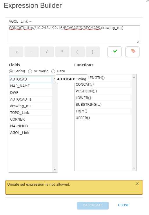

I have a map reference grid that I'd like to be able to click on and have it open an ACAD map stored on a network drive.  I keep getting this error when I try to format the link (drawing_nu is the drawing number that I want to open).  This works fine from within ArcMap, and I'd like to migrate this capability to AGOL.  Any help would be much appreciated!
KellyGerrow
Esri Alum
David Forbuss
Try putting the url that you are using in single quotes. This will let the expression builder know that this is a literal string and not a field variable.
concat('http://<ipaddress>/BCVSAGIS/RECMAPS',drawing_nu)

DavidForbuss1
That worked!  Thanks Kelly!
