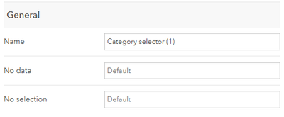

There doesn’t appear to be native support for propagating filters from the parent to the child in dashboards.
Has anyone found a workaround or best practice for this?
Is there a way to simulate filter propagation across related layers in ArcGIS Dashboards?
