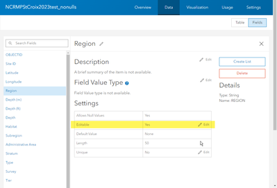

Click the Data tab on the Feature Layer's item page, select the "Fields" option in the upper right corner, and select the field you want to make editable. Change the "Editable" option in the Settings section.
KenBuja
MVP Esteemed Contributor
MattC_1898Co
Thank you, @KenBuja! That was exactly what I needed.
