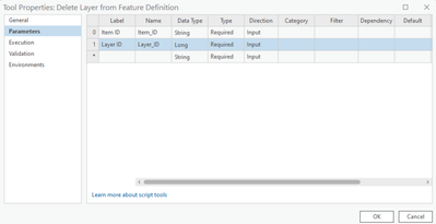

Anyway, I'm writing this post to share a script I wrote to put this functionality into a Python tool that can be run in ArcGIS Pro. I hope it maybe helps someone with this process, especially those who don't have a lot of experience with working with the API.
Regarding toolbox setup, add this script and set the Parameters like this, and it should work like a charm.
