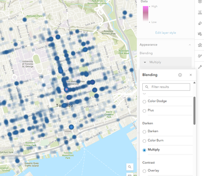

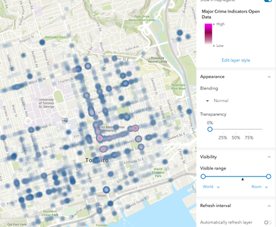

You could try applying a blend mode multiply to the layer and you would see the layers combine. This wouldn't be shown in the legend though. Also this is used for points only and I am not sure well this would look on large extent like world wide countries.
No blend modes applied
Multiply applied
