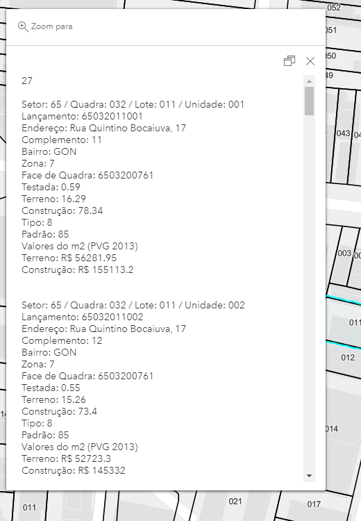

code made it possible to display the data:
Note that here there are some problems to be solved, are these:
fields with domains are not loaded properly to:
  • Bairro
  • Zona
  • Tipo
  • Padrão
 values without decimal symbology and complement from zero to:
  • Testada
  • Terreno
  • Construção
  • Valor Terreno
  • Valor Construção
Question: does this approach allow you to correctly display domains, subtypes, and numeric format?
How to help understanding, the data in my table is as in the figure:

FabioLuiz
Hi @Anonymous User ,
the decode function works, thank you very much.
unfortunately I didn't understand how to use the TEXT () function.
The example I saw was:
- Text (12345678.123, '#. ###, 00') features '12 .345,678.12 '
- Text (1234.55, 'R $ #, ###. 00') presents 'R $ 1,234.55'
I don't know where I put it and if I need to declare a var.
