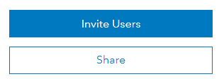

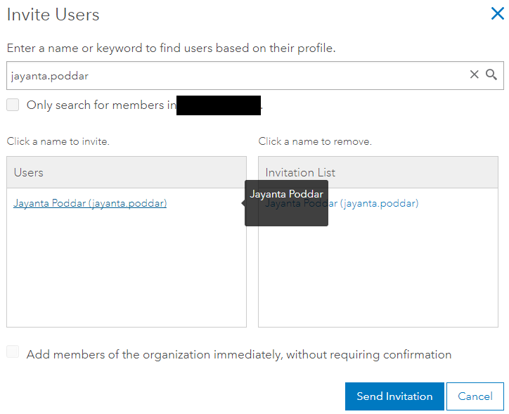

In the particular group page, click on Invite Users.
Search by entering the ArcGIS Online UserName of the invitee.

Also, ensure the user you are trying to invite has the privilege to join groups and has a public profile so you can find them.
Manage profile—ArcGIS Online Help | ArcGIS
