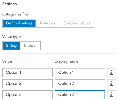

For a category selector and these types of fields, you'd want to get your categories from a list of defined values like this (you can change your display name values to be whatever you want, the left-hand values need to match the options coming from S123):
Set your selection type to "Multiple", this will let you choose just one at a time, or any combo:
Then set the operator to "Contains":

If I'm looking to create a Category Selector in a Dashboard, do you know if there is a way to customize the filter option title?  Ideally, I would like to have a selection list that isn't "Option 1, Option 2, and Option 3" when I'm just looking to grab that data that is titled Option 3.
