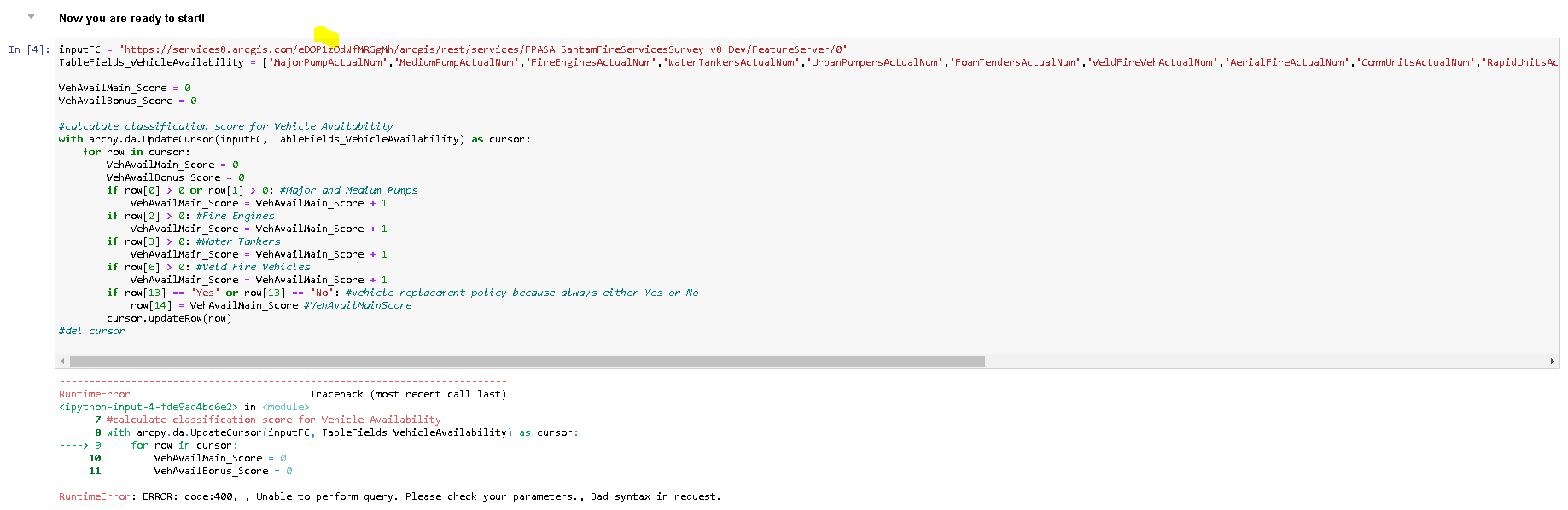

Hi,
I am new to Jupyter notebooks in AGOL. I am trying to develop a script which updates a field in  a hosted feature layer based on what has been entered in other fields. I am getting an error (code 400) pointing to the "for row in cursor:" line. This script works perfectly on my desktop machine. Any ideas as to what might be wrong? Here is what I am seeing in Notebook.
Thanks,
Grant

For one thing, ArcPy is only available in the advanced notebooks (the ones that cost you credits to run), so I'd make sure your notebook runtime is correct.

arcpy and arcpy.da are imported somewhere else in the notebook?
the error stems from the input featureclass name or location or the specified fields.
check both to make sure they "exist" in your code

I found a small error in the fields list which I think was breaking it, so the error is now gone. However, now it doesn't seem to be resolving any of the if statements,. In fact it doesn't even appear to be stepping into the UpdateCursor. I tested this by putting a print statement directly after "for row in cursor:'. It runs with no error but isn't doing anyone of the assessments and incrementing the counter.

that row (row[14]???? will only get updated in the last if statement
print the value prior to updating the row, I can't tell what is going on because flipping back and forth to the image is difficult.  Try code formatting to make it easier to view code samples

Sorry about the problems with image of the code.
Here is the code:
