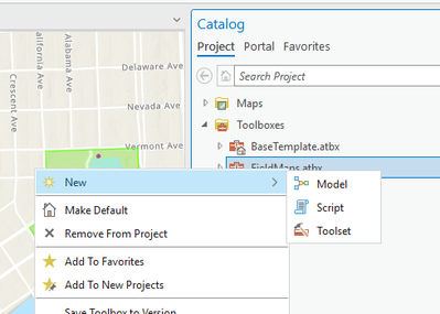

  • In ArcGIS Pro in the Catalog pane, go to Toolboxes.
    • Right click -> New Toolbox
    • Navigate to your project’s Tool folder
    • Name your new toolbox
  • Create a new script tool by right-clicking on your new toolbox and click “Script”.

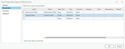

  • In the “Parameters” tab, set your script up like the screenshot. These are the items that the user of the tool with interacts with.MapsInRaleigh_2-1701270263773.png

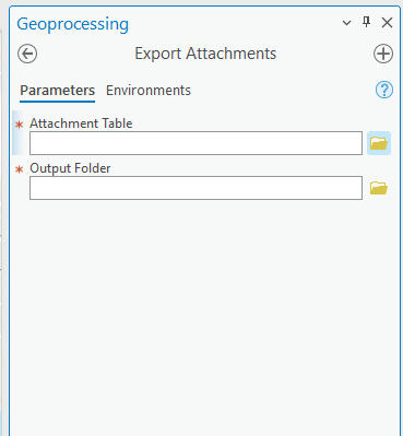

    • It should look like this:MapsInRaleigh_5-1701270263775.png
  • For “Attachment Table”, click on the yellow folder.
    • Navigate to where the downloaded FGDB was extracted.
    • Within the FGDB is a table ending in ATTACH. Click on that.
  • For “Output Folder”, this is the location where all the photos will be saved. Click on the yellow folder and navigate to that location.
    • Remember that the photos will have whatever name was input when the photo was taken. If no name was provided, they will have arbitrary names. Such as “Att22_Photo 5”. They will not be grouped by asset type.
  • Click Run.
    • The photos should all be saved to the folder that was selected.
