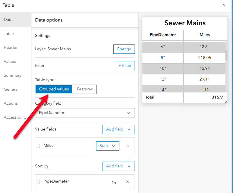

RhettZufelt
MVP Notable Contributor
That function is built into the Table elements in ArcGIS Online dashboards without any code.
Just select the Grouped values, set the field you want to group by as the Category field, choose "Sum" and the value/sort fields.
