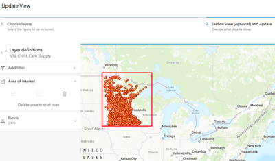

The good news is that I have solved some of the mystery: errors arise from from trying to overwrite a base feature layer which has a hosted feature layer view downstream with a spatial filtering bounding box applied. Example below. I had a few points outside my area of interest, so I figured I could use this HFLV feature to focus my layer. I cannot remember when I set this feature, so I can't rule out that it wasn't the November 2024 that introduced changes here.
I loaded the same CSV used to supply my dashboard into AGOL and published it as fresh feature layers, created spatially filtered HFLVs downstream, and ran into my original issue. First time I was able to duplicated the original issue. When this bounding box was removed, I was able to overwrite in the GUI successfully. However, 1) I was no longer able to edit the HFLV's bounding box (see image below), and 2) the fix did not work for my main layer sourcing the public, production dashboard (naturally). Not being able to edit the bounding box again after it was tweaked once is consistent with my original issue and left me unable to test more then.

Update 2: I raised this issue as a technical support case (Case #03801309) with ESRI. They were able to reproduce and document the issue. It was found as a preexisting bug, BUG-000172493. This was submitted after the November 2024 update of AGOL and was reproducible on that version.
Turns out, the key issue was that my feature layer had an associated hosted feature layer view with a spatial filter, as I noted in update 1. The known bug states this as a limitation of AGOL:
Overwriting a hosted feature layer in ArcGIS Online fails if the layer has a joined view or a view with an area of interest defined.
This isn't very satisfying, and I do not know whether ESRI will plan to patch this bug. But, to answer my own question posed here, yes, the November 2024 AGOL update introduced an overwrite bug for feature layers with associated hosted feature layer views with spatial filters. If I learn anything more about planned fixes, I will update this post.
