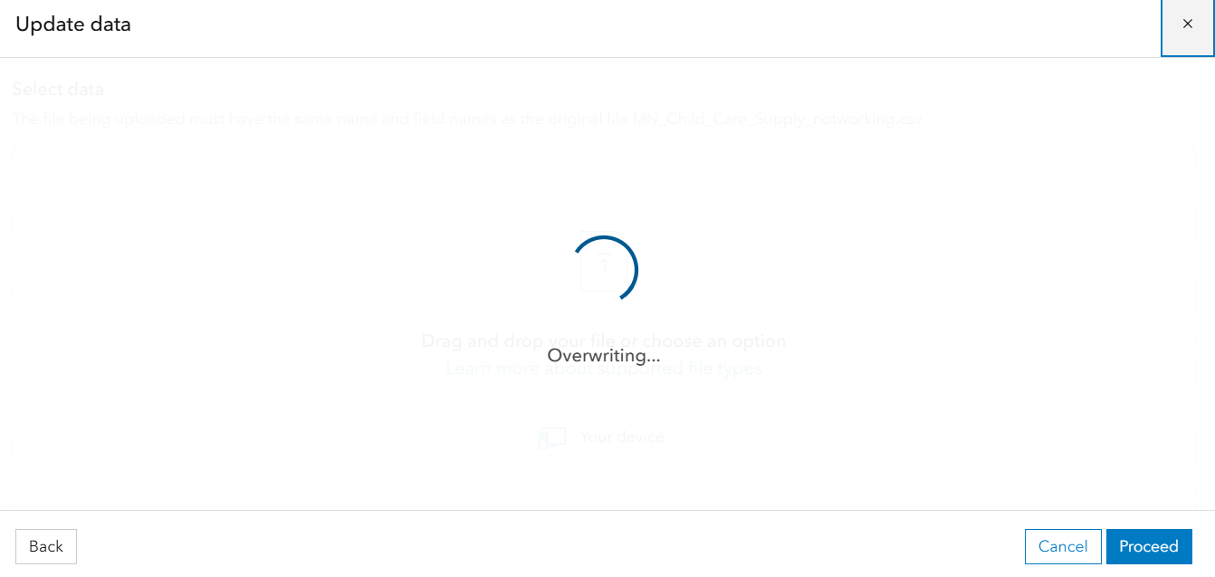

I have attached the GUI screenshot of the error message as well as the text of the python API error messages. I cannot share the data or feature layer itself due to data privacy constraints, but the layer in question is feeding the layers with the child care provider points on this dashboard. I can add the columns and their types too if that is useful. Any help would be welcome; many thanks.

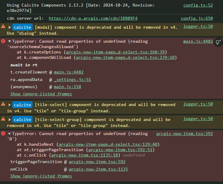

@timcneil good thought. I got a couple different errors. All pasted below.
The first was when I tried to overwrite from the web UI.
The second was when the overwrite had fully failed and I was on the https://ccaoa.maps.arcgis.com/home/item.html?id=redacted&jobid=thejobid page. I tried to overwrite again and got the `cannot read properties of undefined "sourceSchemaChangesAllowed"` error. Googling the latter didn't help me make sense of it, but perhaps this gives you a hint at what is happening here?
