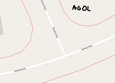

Our parcels use true curves when we create them from COGO using the Traverse tool, and they look fine in ArcGIS Pro.
But in ArcGIS Online, they look like jagged edges. This could affect the various widgets that are selecting abutters and other features based on a buffer not to mention it just makes them look unprofessional.

Mine are still the same as the image above.
JoshBerna
Glad I'm not the only one. I used the densify tool as a workaround and populated the curves with a bajillion vertices but they still look all jagged in AGOL. They look gorgeous in Pro, so im pretty peeved off.
