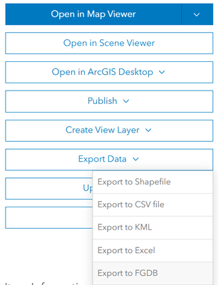

I usually go with the Export Data button on the hosted feature layer's item page:
