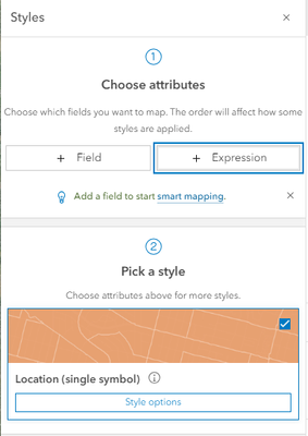

Are you putting the expression in here:
You would need to replace the "LastMaintained" with Grade_date (if you delete everything after the dot then it should show you a field list to pick from with the intellisense)
You can always click run inside the expression window to check it is giving you a viable answer.
I am also assuming that your "Grade_date" has a field type of "date", rather than being a string or a number.
Assuming all this is correct then you pick a style in your case "Types (unique symbol)" and then set your symbology - one for "Overdue" and one for "Not yet due"

RichardHowe
