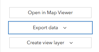

When you 'Save' a Layer in Map Viewer, you are saving the Properties configured on that layer in that map, such as the style, field names, and pop-ups. 'Save As' can be used to create a differently styled version of the same layer, maybe one with a filter, or different visible fields.... essentially providing another way to view the SAME data.
One way that you could create a SEPARATE copy of a hosted feature service would be to:
  • Export the layer,
  • change the name,
  • and then upload that to ArcGIS Online.
This video can walk you through the steps.

EmilyGeo
  • Export the layer,
  • change the name,
