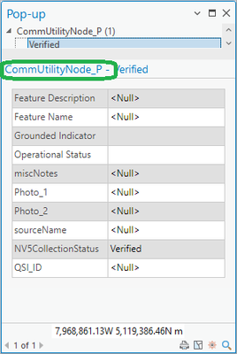

In ArcPro the pop-up displays the following. CommUtilityNode_P is the feature class. It is correctly displaying the feature class and the Collection Status.

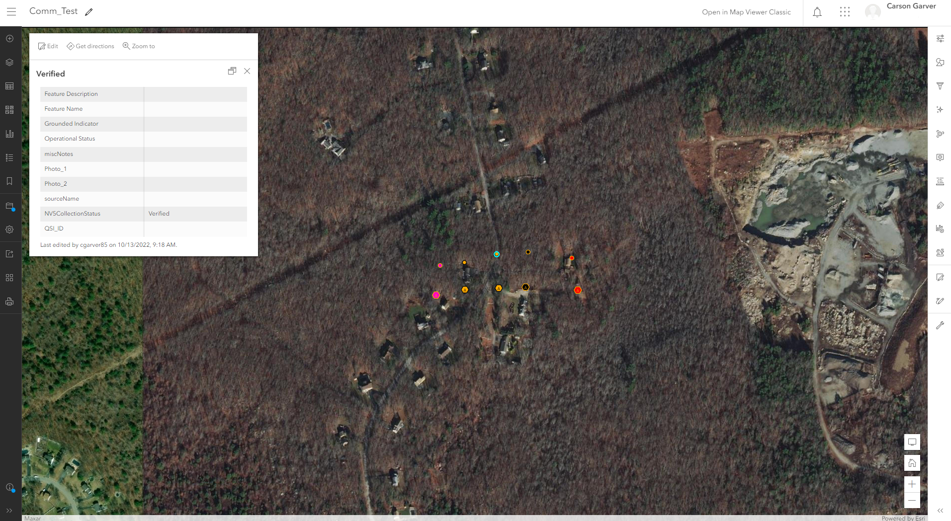

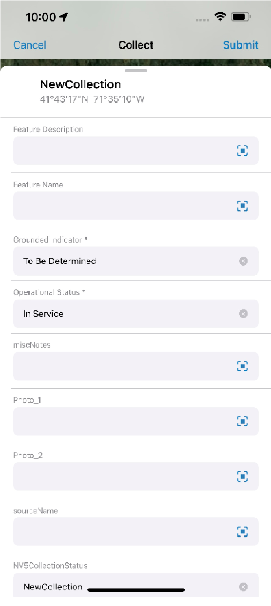

In AGOL and consequently in Field Maps it is only displaying the field NV5 Collection Status.

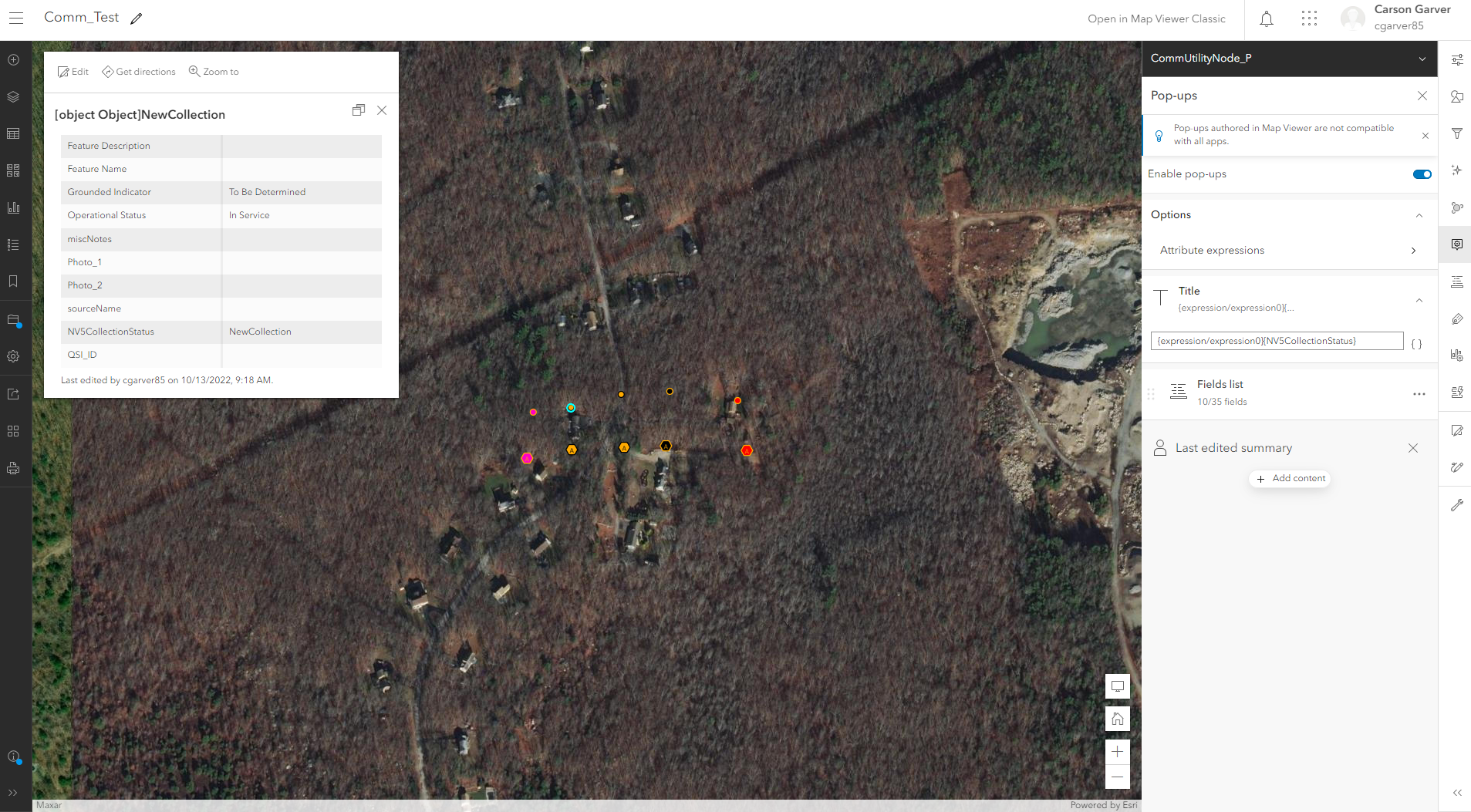

I tried some arcade expressions for the title pop up including $layer or $feature but they only display [object Object]

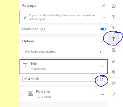

You can set the Title from the Pop-Up Configuration in your Map Viewer:
CarsonG
I understand I can set the Title from the Pop-Up Configuration, as that is what I have done by including NV5CollectionStatus in the title as displayed in the fourth screenshot. I want the title to reflect the Feature Layer of the feature that is being identified by the Pop-Up.
