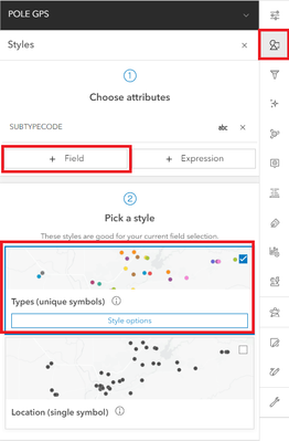

Here is where you would add the field that controls the status. (In your case "Order Process"), but in mine it would be "Subtypecode" for my Pole feature layer.
Select style options "Types (unique symbols)". Here you will be able to adjust the points size, color, shape, etc. based on the list of the status of that field (Yours "Order Process", mine in this example is "Subtypecode"):

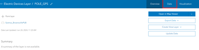

If the list does not appear, see if you can access the data in AGOL to get to the fields.

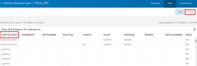

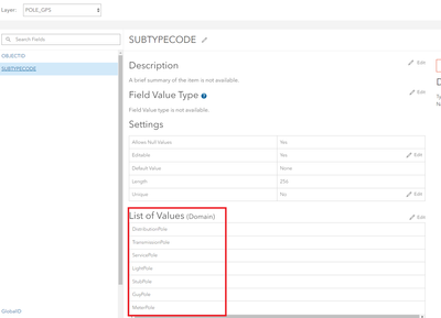

For my example, on the Pole feature layer fields, I use 'Subtypecode' as the field that will determine the color/symbology. I have assgigned a list of different options under the 'Subtypecode' (Yours would be "Order Process").  Select "Fields":

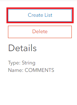

There will be a "Create List" on the ltop left in the Fields tab:

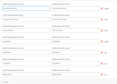

Create list:
List created in 'Subtypecode' field of  Pole feature layer:
Then go back to AGOL Map Viewer, repeat the first steps and see if the '+ Field' option recognizes the list for that field. Hope it helps.
