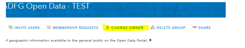

I am the Administrator for our AGOL. How do I transfer ownership of a group from one user (who used to be an administrator) to my account?

I replaced the graphic...does it look better?
I'm taking an online course and I think all the meetings and code sharing apps are messing with my browsers.
In case that didn't help (looks ok on my screen), go into the group (metadata/info page for the group )and there is a "Change Owner" button/option on top.

If you have admin rights to the group, which you should if you are the AGOL administrator, go into the group and there is an option on top

I cannot see your response. Looks odd.
