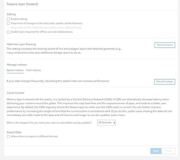

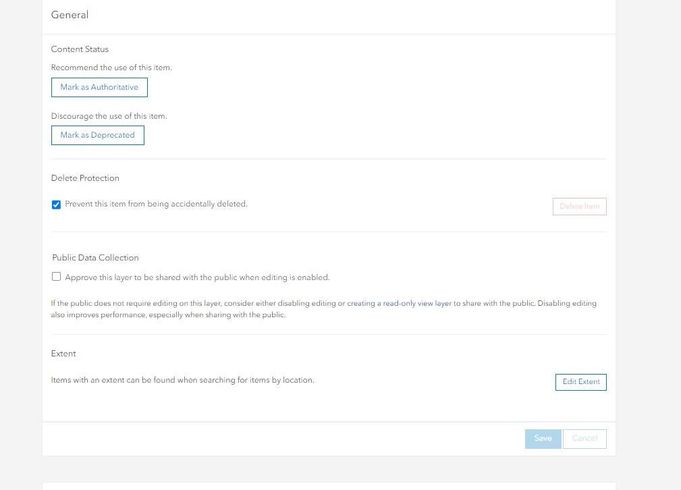

Hi @EmilyGeo,
Sure thing, here are 2 screenshots of the layer settings. Note that I have not altered these settings before the issue arose. I have tested different checkboxes and setting selections after I noticed the error to see if I could figure out a solution, but have returned them back to how they were when I originally created the layer before the sharing issue.

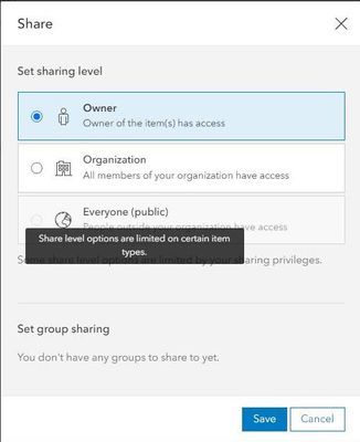

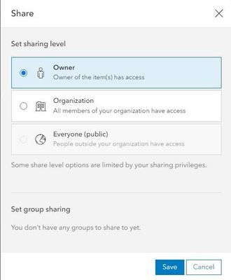

Here is the sharing dialogue box. The first screenshot below is with me hovering over the 'Everyone (public)' button to display the additional text.
I have tried opening AGOL on other browsers, such as Firefox and Edge, but the sharing issue still shows up. Attempting to update the sharing status on mobile resulted in the same issue.
