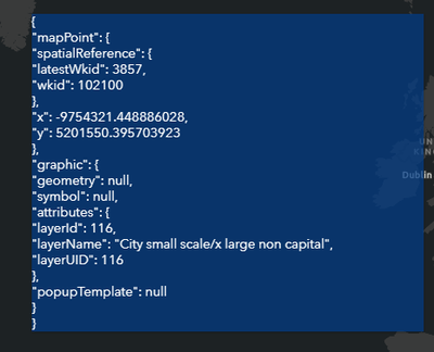

Are there any updates on this? We had a use case where we want to get some attribute information on mouse over such as the name of the location they are hovering over.
I believe this information exists in the Esri tile layers, it just isn't exposed by hit test. To demonstrate this I include two samples both using the same Esri Tile layer (they look different because one is styled one not). Once using the open layers API and the other using Esri JSAPI
Open layers
https://codesandbox.io/s/esri-vector-tile-mouse-over-open-layers-293f6https://codesandbox.io/s/vecto...
JSAPI
https://codepen.io/davidwilton/pen/RwVXgva?editors=1000
With open layers I not only get the name of the item but also the NLS
With Esri I get nothing but the layer name
