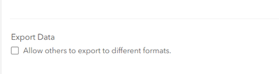

Yes, this is possible. In addition to ensuring that the hosted feature service is shared correctly, you'll need to check this box in the Feature Service Item Details > Settings tab > Editing section.
