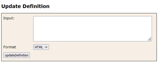

I am trying to update my Admin REST endpoint for the hosted feature layer but once I click on update service definition it gives me
error in updating as the picture below

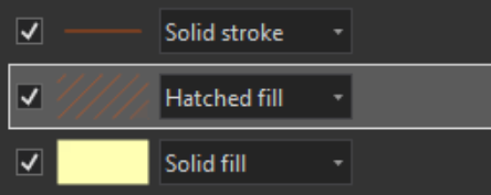

I am trying to micmic a hatch symbol fill over a fill symbol fill (multi-layers symbol),  as follow:
ArcGIS Pro symbolArcGIS Pro symbol
When shared to ArcGIS Online, only the first 2 layers displays. It looks like the plain yellow fill is not in the  JSON file.

Hello. Your post really helps a lot of people. I thank you again!  When I update the color RGBA and click the 'Update Service Definition' on the bottom, it doesn't update when I check the layer on webmap when adding it from the URL.  When I go back to the Admin Update Service Definition page, the RGBA #s went back to original.  Am I missing some step?  Thank you.
DeVoe_William
You should be able to change the color in the drawingInfo section of the JSON, but I do not think there is anyway to change the width of the lines, or to overlay multiple line layers as you could do in ArcMap. For this sort of complex symbology you would have to publish a service through ArcServer not AGOL.
BritaVespere
Seems that Map Viewer Beta works well with hatched symbols published from ArcGIS Pro. I can even change the hatched line color. But not line width.
