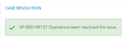

I had completely forgotten about this bug report so i went back thru our Org's history and found the case. I believe Esri claims that the issue had been resolved:
Despite their claims i still experience the same buggy behavior

SP indicates this issue is tied to a service disruption and is generally handled by the operations team.
It's possible that this type of issue may re-occur if the service disruption reoccurs, as opposed to a more conventional bug. Meaning if you suspect the issue is occurring again, a new support case and investigation will need to be opened.
