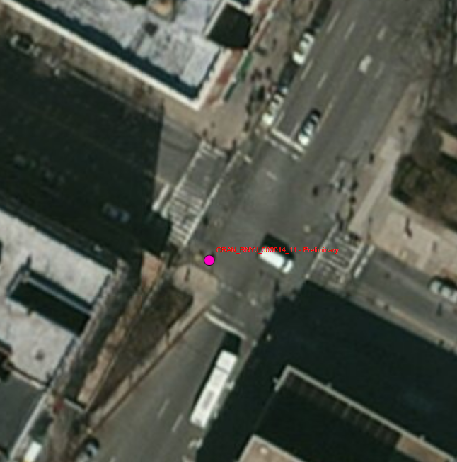

It wouldn't really be helpful...see the images below:
This first image shows the closest zoom allowed by Bing.  You can clearly see the poles that we want to look at.

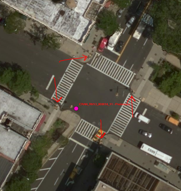

Now here is Esri's basemap...you can barely see anything, with the exception of the traffic signal on the right side.
This particular example isn't even a bad one either.  Most of the time you can't make out the poles at all...  Bing does a really good job at reducing shadowing as much as possible, and there is little to no building skew that occurs due to camera angle.
