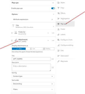

Yes, in order to work with attachments they first need to be enabled on the hosted feature layer.
Then to view them in the pop-up, you need to add the attachment element in the pop-up.

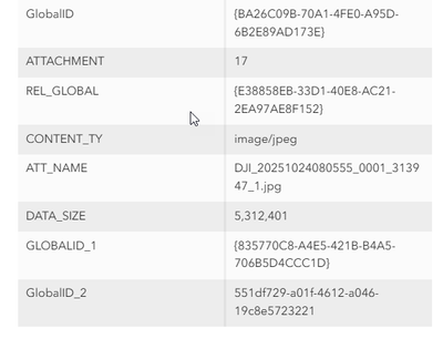

Although I have carried out the above steps, I still cannot see the pictures in my pop-up window within my web map. See screenshot below;
KateEkhator
Forgot to add pop up window;
No picture in pop up window.
EmilyGeo
Hi @KateEkhator
It seems like the attachments didn't upload correctly.
You could try uploading the file again, or if you don't want to start over from scratch, you could try to 'Update' the existing layer following the steps outlined in this article: https://www.esri.com/arcgis-blog/products/arcgis-online/data-management/add-attachments-with-ease-us...
