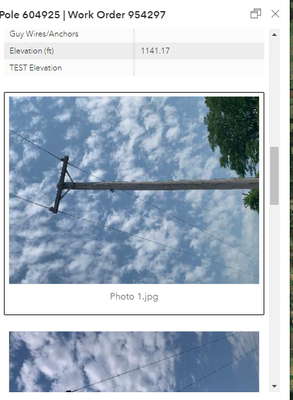

I have an aesthetic issue with the pop-ups coming in. all of the images that are attached and collected in the field are only being viewed sideways not up and down. It there a code I can use to rotate the photos so they are correct?

I'm having the same issue. This occurred when we moved form ArcGIS online to ArcGIS Enterprise and they show sideways in portal pop-up window.

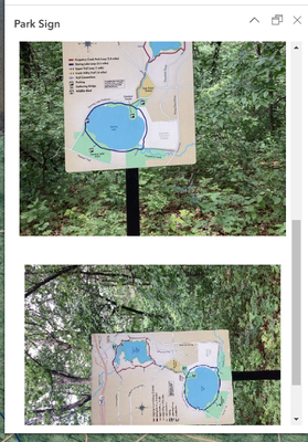

This code works for features where the attachment table was created in pro as a result of the Enable Attachments action (which is where we get the AttachmentID field and the related Global/Rel_GlobalID fields. And in fact this code does work to get the attachment and orient the picture correctly. The top photo is with the Media element, the bottom is with the Attachments element:

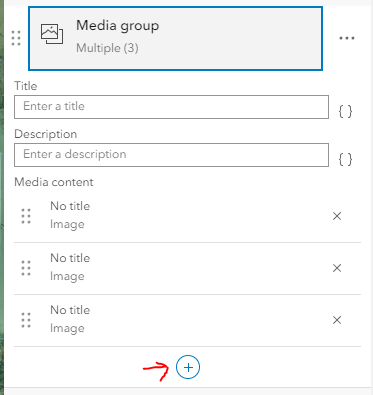

Anyway, the next step is to make your Media element a Media group:

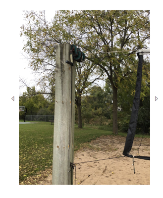

We'll need a new content item for each photo. The result is a scrolling media block that contains as many photos as you've added, correctly oriented:
