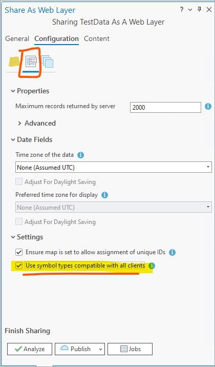

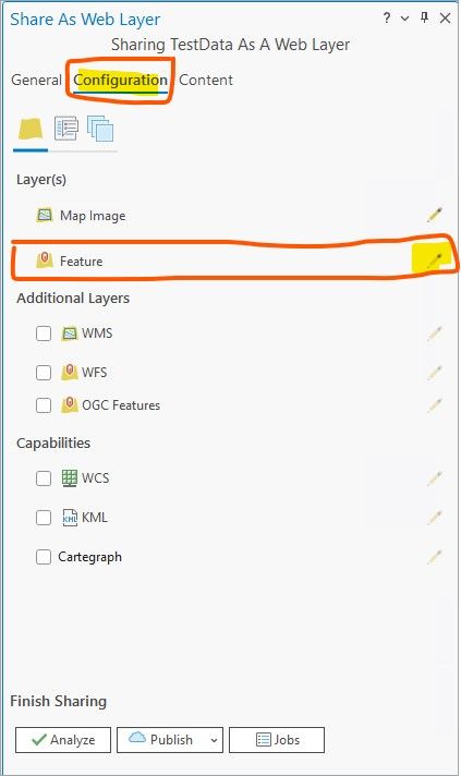

When you publish a map with a feature service, you have to click the "Configuration" tab, then click the pencil to edit the configuration settings on the Feature Layer.  Then again click the "Configuration" tab, and toggle the checkbox ON for "Use symbol types compatible with all clients".  Screenshots below.

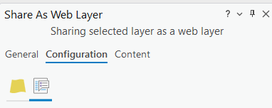

What if you're publishing a web layer not a web map -  there's no "use symbol types..." check box for the share web layer option? It degrades the symbology for the layers when opened in Map Viewer Classic.

Hello @RussRoberts - I am having a similar issue where I do not see the "Use symbol types compatible with all clients" checkbox when overwriting a web layer. I checked quickly to see if that would be the case for sharing a new layer, but I also did not see the checkbox.
