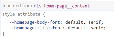

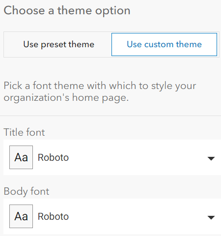

I've noticed that the typography on the ArcGIS Online home page is not updating, regardless of whether I chose a preset  or custom font, it always defaults to "default, serif" for the home page font.
What I want:
What I get:

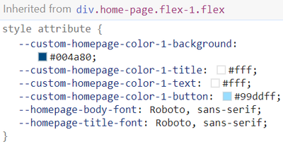

If I uncheck "--homepage-title-font" and "--homepage-body-font" in the developer tools, I get the font I want from the first screenshot.

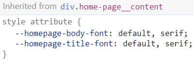

mpboyle
We work with Edge, however I get the same when using Chrome.
What I see when loading our AGO:
When I uncheck the styles shown in the first screenshot below from Developer tools, I get the Roboto font, which is what I'm setting in the AGO typography (last screenshot below).
