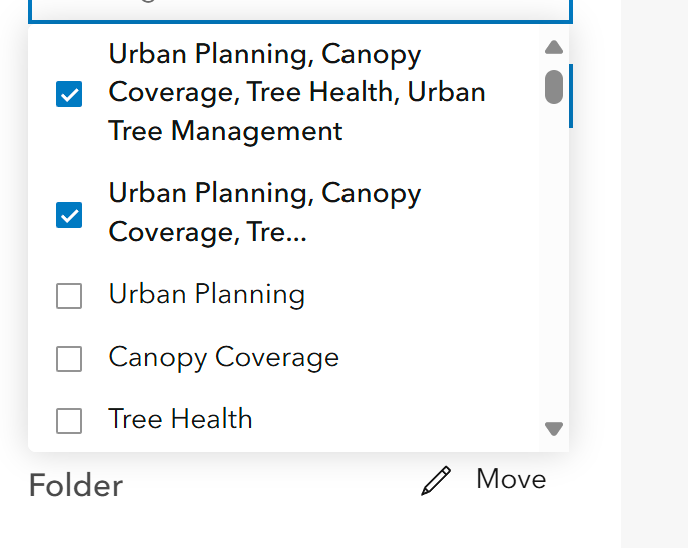

BrandonGuo
In the past, I can copy and paste tags in one go, and AGO can correctly identify and separate them. For example, copy "Urban Planning, Canopy Coverage, Tree Health, Urban Tree Management", AGO can identify the comma and add correctly.
After the June update, it just shows all tags in one.

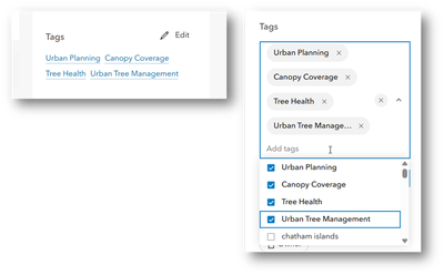

BrandonGuo
The screenshot shows two tags, because I tested twice. However, I pasted four tags separate by comma. In the past, after user paste and press "enter", ago will auto identify the comma and separate them.

BrandonGuo
Yeah, right. AGO will not display the tags separately. But after saving tags, it did save all of them separately. Seems only have display issue, which will make user think the system can't identify comma.
