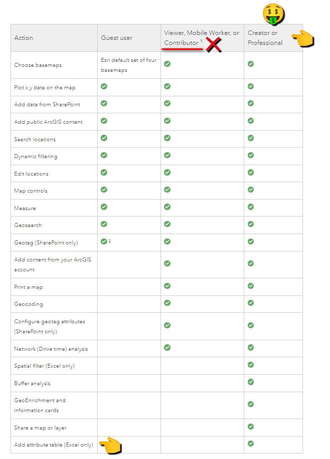

However, the other two users in the group—both set as Contributors and Data Editors—can only add the layer to the map. The table icon is grayed out for them, and when they hover over it, they see a message saying they don’t have the right permissions.
I’ve attached an image for reference and outlined all my settings here in case anything is unclear. The same image is included in this text and also attached as a file in case it's easier to view that way.

Update-Figured it out.
Basically the image below explains it all. But here’s the interesting part: If I do it as a Creator and then send the Excel file to someone with a Data Editor role, they can fully edit the table and add as many layers as they want in the ArcGIS for Excel plugin. They just can’t pull in attribute tables themselves.
Now, I’m looking into Power Automate for a workaround because I really don’t want to spend an extra $700 on more Creator licenses—or be the one setting up Excel files for everyone. Hopefully, the ArcGIS Excel Power Automate tool solves my problem… TABLE.jpg
