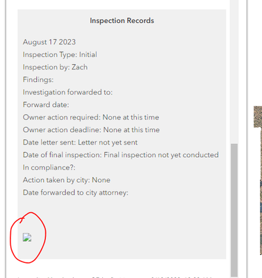

Okay so actually I "figured out" the comma problem by deleting the regualar brackets after Push and then just enter new ones. So there's that. So now I'm very close! I wrote the code as an attribute expression:
// related table layer
var fs = FeatureSetById($map, "189ffea4bbf-layer-175")
// get matching feature based on GlobalID to GUID Relationship
var match = First(Filter(fs, `CompRel = '${$feature['GlobalID']}'`))
console ("fs: "+fs);
console ("match: "+match);
// get matching feature's attachments
var atts = Attachments(match)
console ("atts:" + atts)
// push attachment urls into array
var urls = []
for (var att in atts) {
    Push (urls,`<img src="https://gis.edenprairie.org/maps/rest/services/Internal/CodeViolations/FeatureServer/1/${match['OBJECTID']}/${atts[att]['id']}"></img>`)
return Concatenate(urls, '<br>')
and then go add that expression into a text section in the popup but just get this:

I got it to work!
The URL link was missing the /attachments/ portion in between /${match['objectid']}/${atts[att]['id']}"
Hope this helps!
