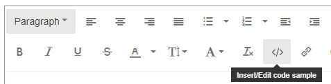

To post code:
JohannesLindner_0-1674589814049.pngJohannesLindner_0-1674589814049.pngJohannesLindner_1-1674589827880.pngJohannesLindner_1-1674589827880.png
