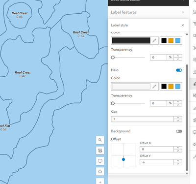

Unfortunately, you can't use formatting tags in Arcade for labels on AGOL. What you would have to do is create a separate label class for each type of name. In each label class use the Label style to set the font and Offset Y to provide the proper spacing
