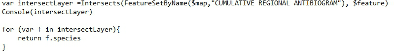

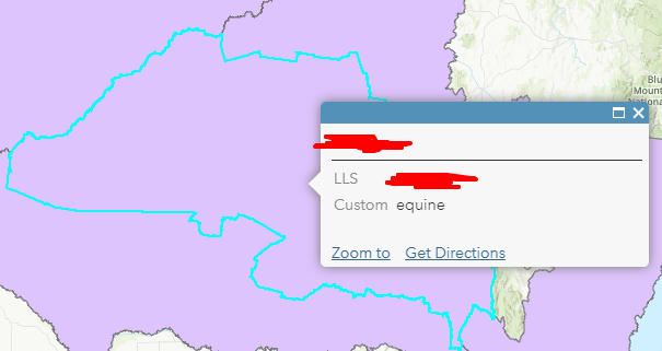

1) Intersect a point feature layer with related table with regional polygon feature layer (LLS Layer is where the Arcade expression is being displayed in pop-up):
This portion works ok, but I may need to know the count of 'species sampled'. f.species is within the feature layer.

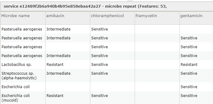

2) I wish to summarise records in the point feature layer related table:
   End result is pop-up will show:
  • region name [from feature layer]
  • f.species and count [from feature layer]
  • microbe name and the count of microbe (eg. above would be 'Pasteruella aerogenes: 4 samples') [related table]
  • Each test item and count (eg. 'Amikacin - Intermediate (3 samples)) [related table]

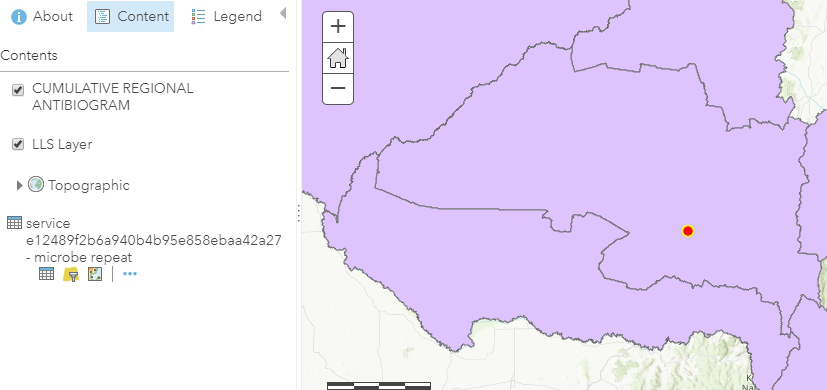

Doing a little test on your data, I think there might be another challenge: performance. As far as I understand you want to click on the polygon, query the intersecting points and retrieve all related data stored in a table of those selected points.
Have a look below what this would look like:
