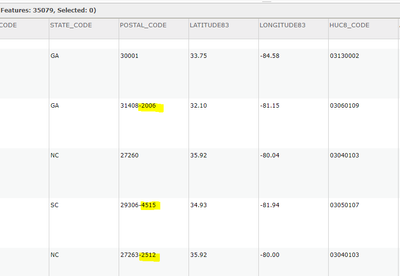

  • I have a field named: $feature["POSTAL_CODE"]. It contains zip codes.
  • I also have a list of zip codes: 28712, 28717, 28734 , 28736 , 28741...
  • My goal is to check each row of $feature["POSTAL_CODE"] against my list and if a code on my list is present return a 1 otherwise a blank
  • I put together the code below which works as intended, the only issue is that some of the zip codes in $feature["POSTAL_CODE"] are in zip+4 format (ex: 28712-xxxx). For these row my code does not work. I'm only concerned that the first 5 characters of the of the zip code string match. Is there a way to modify or rewrite this so that it works for the handful of rows that have the zip+4 format?

Try subsetting the postal code field:
var zip = Left($feature["POSTAL_CODE"], 5)
That way if there's anything more than 5 digits, you still just get the first 5.

RoscoPeters17
Thanks @jcarlson. Not sure why I didn't think of that.
