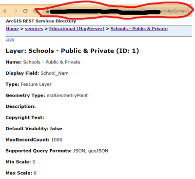

My example is an agol feature service. Ours is a stand alone arcgis server portal, but not a federated Portal. They are both technically portals, it's a wee confusing that way. Not sure what yours is!
Anyway, what I do is create an "item" in AGOL and then link it to something on our rest end point. So even though the rest end point is actually a different url, I still use our AGOL portal because technically the item is hosted in AGOL where as the linked content is on our stand alone server.

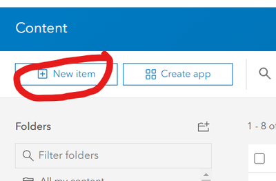

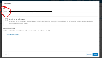

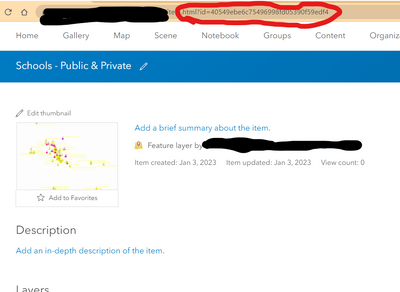

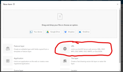

Teresa_Blader
Sure:
In AGOL, "New Item", Use URL option, copy and paste your service url from the rest end point. Create, give it a name, then use the item ID in the url for that item to call it into your arcade expression.
