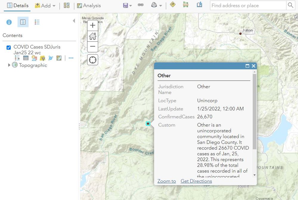

Hello all,
I am pretty new to the new Map Viewer, so maybe I just missed a step.
I am customizing the pop-up in the new Map Viewer using Arcade. The expression works when I hit Test, but the Pop-up in the new Map Viewer only briefly display a spinning circle and doesn't display the message created by the expression. I have tried re-doing it, restarting the map viewer, but it doesn't work. When I put the same expression in the classic Map Viewer, it immediately works. Any ideas? Any assistance is greatly appreciated.

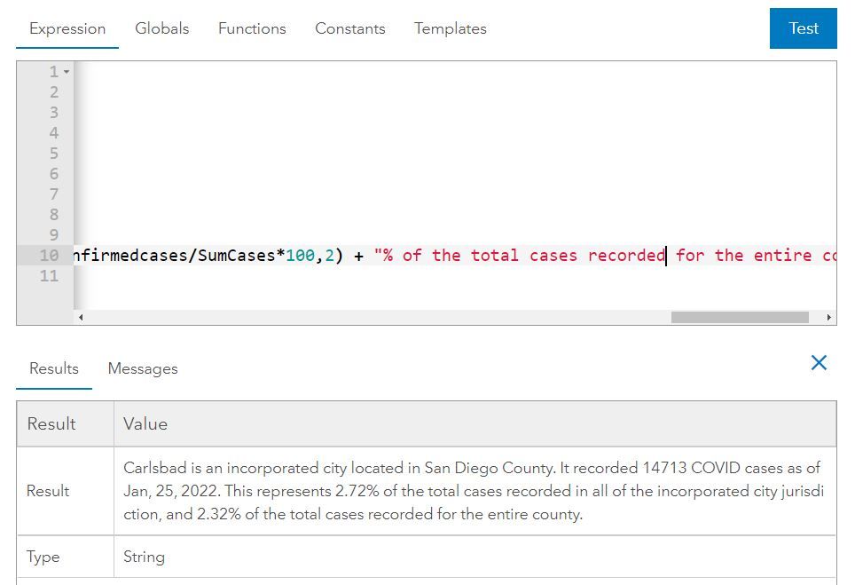

Here is the expression:
var LocCodes = {
"incorp":"incorporated city",
"unincorp":"unincorporated community"
var Loc = $feature.loctype
var LocDesc = LocCodes[Loc]
var SumCases = sum($layer, "confirmedcases")
var FilterCases = sum(Filter($layer,"loctype=@Loc"),"confirmedcases")
Return Proper($feature.name) + " is an " + LocDesc + " located in San Diego County. It recorded " + $feature.confirmedcases + " COVID cases as of Jan, 25, 2022. This represents " + Round($feature.confirmedcases/FilterCases*100,2) + "% of the total cases recorded in all of the " + LocDesc + " jurisdiction, and " + Round($feature.confirmedcases/SumCases*100,2) + "% of the total cases recorded for the entire county."
Tested fine for the new viewerTested fine for the new viewer
Expression tested fine in the new and classic viewer
Arcade expression doesn't show in new viewer's pop-upArcade expression doesn't show in new viewer's pop-up
New viewer pop-up fails to update with the message from the expression
 Classic viewer pop-up updates with the message from the expression

WingCheung1
Thank you Amada. I figured out what I was doing wrong. I added my Arcade Expression using the +Add content icon instead of Manage Expression. Once I went through Manage Expression and added my expression there, I was able to see my expression in the Fields list and include it in my pop-up. Thanks!
