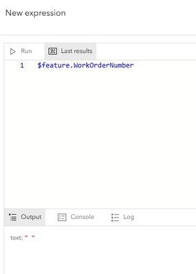

Is the data in the WorkOrder Number field truly a null value? Or could it just be an empty string with a space or something like that? As a quick test, you could try returning the value of the WorkOrderNumber variable in the Arcade expression, just to see what it is saying the value is.
a_bakiera
Here is what I got
RyanUthoff
MVP Regular Contributor
Yeah, your records aren't truly null. It looks like it is just an empty string, or a value of a single space or something. If it was truly null, it would look like this:
So your Arcade expression is working correctly, you'll just need to either correct the data to make the values truly null, or you'll need to account for empty strings/spaces in your Arcade expression.
a_bakiera
Ok good deal. Thank you for catching that. I ended up nulling the records and that solved the problem!
