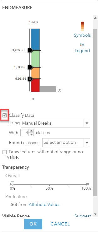

If GPM is an attribute, in the Map Viewer you can Change Style and in the drop down box for Choose an attribute to show, select GPM. For the drawing style you can select Counts and Amounts (color) and hit the options button . From there select the check box for classify data and in the drop down menu select Manual Breaks. This way you can set your ranges. Select symbols on the right side next to your range bar and at the very bottom there's a color range for Red-Orange-Green-Blue. Select OK and then Done. This should (hopefully) give you the classification you're looking for.

Understood. Your idea of creating placeholder attributes in the meantime will also work this way in AGOL. The Choose an Attribute to Show drop down menu will show the field names, this is where you would select your GPM field name. Once you start importing data for GPM in the field, that data classification method will yield the visual results you're looking for based on the range it falls under.

taking a few dummy points and then using the Counts and Amounts (color) style seemed to do the trick!
