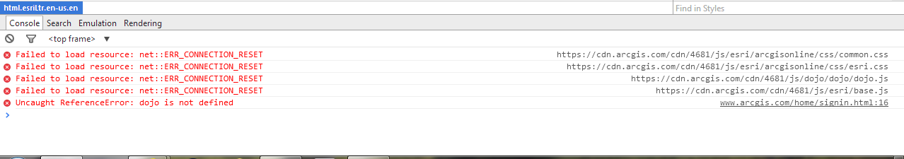

The link doesn't load any browser I have. These are the errors I see when inspecting the element in using the chrome developer tools.

The errors match the script content at the top of the log-in page. So, that looks to be simply browser security blocking. Maybe  need an exception for the site.
